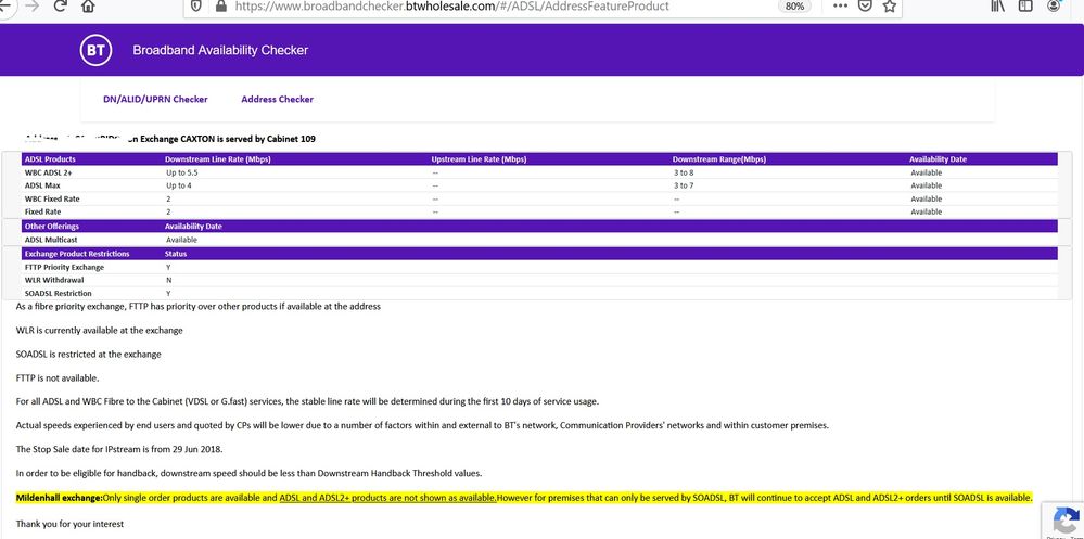

Hi @iniltous - thanks for the reply.
This is the result of wholesale checker for the address I'm due to move to:
And this is the result for the immediate neighbour (it's an end of terrace house) so just the 1 immediate neighbour:
After getting in touch with the letting agent, they've let me know that the property is currently being lived in by the landlord, and apparently they've never chosen to upgrade to fibre, as were happy on the ADSL service they still have.
I'm hoping that as every single other property in the same street has FTTP, that I can get it too - but because the Openreach fibre checker website says it's unavailable in my area, I can't place an order for it... Wondering if it's something that can be updated by Openreach, but I can't find anyway to contact them. A bit stuck!
