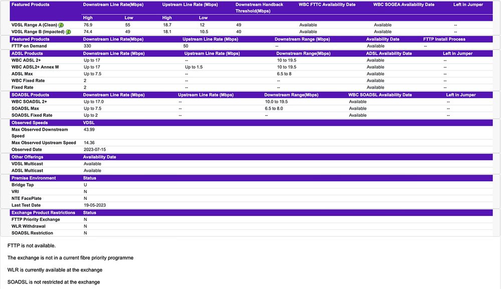

Wholesale report says VDSL High is 76mbps - so it suggests the line is capable?
Just to clarify - I am getting the speeds advertised on my package (Fibre 1) the issue is I am no-longer offered Fibre 2 when I look to upgrade which is due very soon and this is the max speed package I can get now with BT, even though I was once on Fibre 2 they tell me it's no longer possible.

According to dslchecker your current speed is 44 down and 14.3 mb up. The 14mb upspeed suggests fibre 2 as max for fibre 1 is 10mb.  Also shows possible speed range 76/55mb

Looking at the checker result, you are already on fibre 2 as can be seen from an observed upload speed of 14.36M.
However, your downstream speed  has been banded by DLM to 44M due to instability.

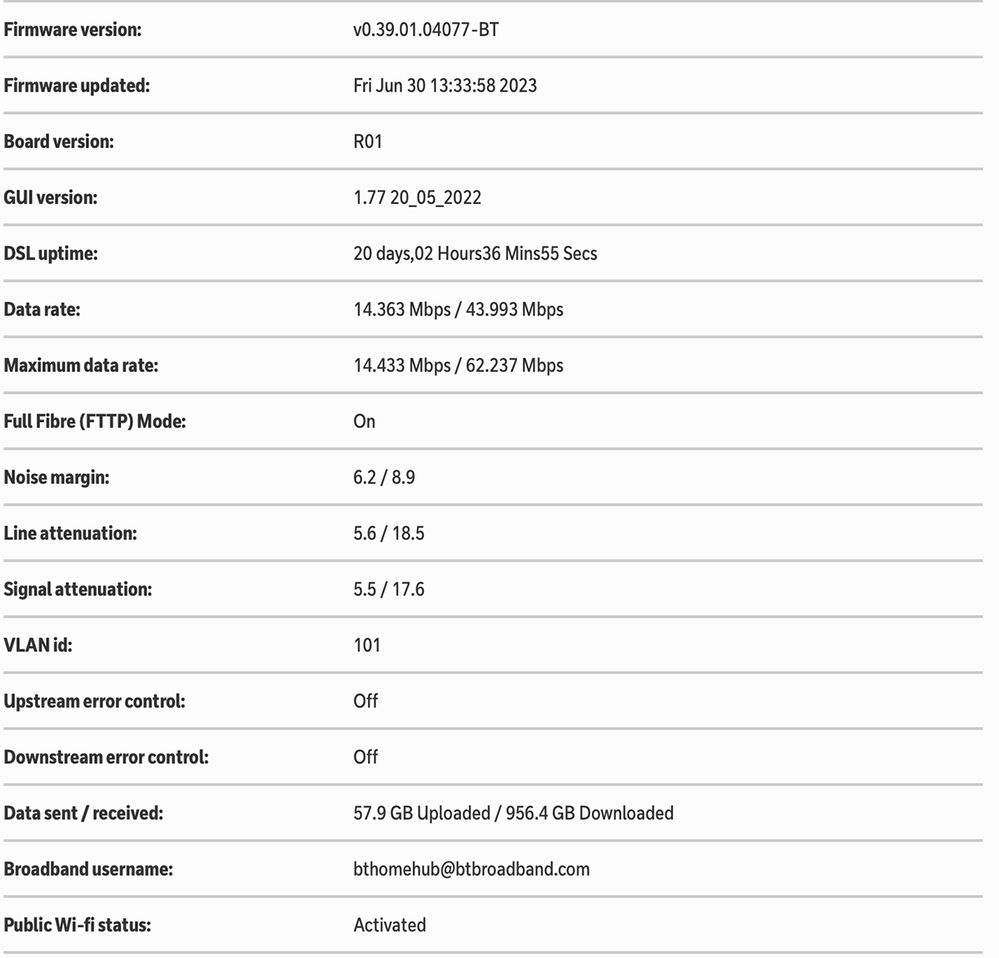

Is this what you mean?
Full Fibre (FTTP) Mode:On
Noise margin:6.2 / 8.9
Line attenuation:5.6 / 18.5
Signal attenuation:5.5 / 17.6
DSL uptime:20 days,02 Hours16 Mins51 Secs
Data rate:14.363 Mbps / 43.993 Mbps
Maximum data rate:14.443 Mbps / 62.287 Mbps

Here are the full stats, thanks for the help.
