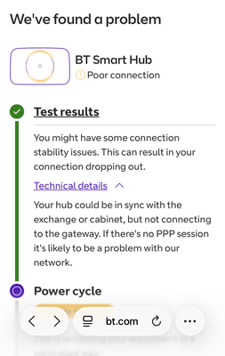

This is the result I get from the fault finder on the new hub.  Same as on previous hub
“we’ve found a problem
you might have some connection stability issues
your hub could be in sync with the exchange or cabinet but not connecting to the gateway.  If there’s no PPP session it’s likely to be a problem with out network”.
anyone know what a PPP session is?

Point to point protocol, it is the underlying network protocol.

@DHC123 @licquorice  I have the same issue.  Since 28 October, I have had my Full Fibre  FTTP 300 service drop out randomly and without notice or a message.  Service just slows and then stops with a "No Internet access" mesage associated with my Smart Hub 2 connection on my PC.  I just had this again, the 6th occurrence including the 28 October incident.  The Hub and WiFi discs lights remain Blue.
Each time I use the 61998 BT Diagnostics Bot that does a REFRESH to restore the connection.  Other than the hub restart, the Hub and WiFi discs light Blue. This is annoying as the timing can be afternoon or evening.
There are no household events - power outages, router movement, flooding, etc - that might impact the the target receiving units.
The 61998 BT Diagnostics Bot suggests that it might be "the equipment in your home (your hub and WiFi)" or "the line from the network to your home appears to be performing well."
Tonight's 61998 BT Diagnostics Bot "the line from the network to your home appears to be performing well" diagnosis and the BT Guide enagagement engagement highlight a "Your Hub could be in sync with the exchange or cabinet, but not connecting to the gateway.  If there is no PPP session, it's likely to be a problem with our network" diagnosis.   An outage from 17:14 to 17:48.  Hub Technical log shows lots of PPP logs during recovery with a final entry at 17:40 :57, so there is a PPP session.
17:40:57 14 Dec. PPP: IPCP up
As our connection has come back and as this is the 6th occurrence in 48 days, I think the Power Cycle recommendation is an unnecessary and additional waste of my time and a distraction from the real problem,
There was an OpenReach van at my neighbours on Friday.  Is the FTTP unit on the BT telephone pole shared or unique to each installation?  Could my connection have been disturbed during an installation?
The BT Guide report of the problem could be more specific and helpful.
