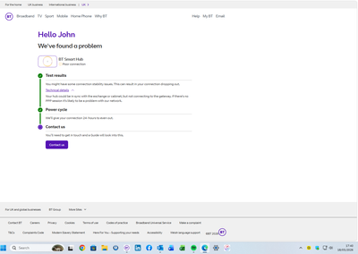

With all due respect @licquorice, I am at a loss to understand why you would choose to proclaim on a public forum, that a physical problem with the external cable itself, could not possibly affect the strength of the incoming light signal to the customers ONT. For your information, I have enclosed the most recent error report which clearly implies, that although my Hub may be in sync with the exchange or cabinet, it is experiencing issues in connecting to the gateway. More to the point, it specifically states that if there is no PPP Session, it is likely to be a network issue. As my problem is clearly external and has been ongoing for so long, why is it so unreasonable of me to request that the cable is replaced, particularly as it is the only avenue that has not yet been explored.
