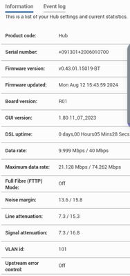

in order for the forum members to help please can you post the stats from your router (if hub enter 192.168.1.254 in your browser) then advanced settings then technical log information .
Are you connected to the mSter socket currently?  If so have you tried the test socket behind the faceplate to see if that helps

You are on a 40/10 profile and the line is capable of a lot more. It may be that the fault had been there for so long that the system that monitors line-attenuation performance assumed that was all you particular line was capable of, and that’s all you would have been offered. (It happens on long rural lines all the time when houses off one DP can be 100’s of metres apart).
Speak to the advisor again and find out what profile you were sold and if you can have it changed to 80/20.

The profile is 40/10, so that’s all you will get. The next step up is 80/20, if you were on that you’d probably be looking at around 70-75/20 speeds.

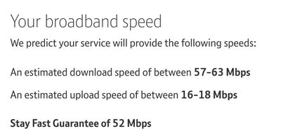

If I try order Fibre1 now, it goes up to 50? Not capped at 40.
Fibre 2 would give me a bit more:
3,507 Views
