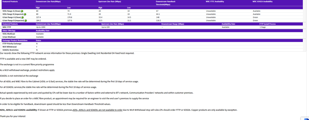

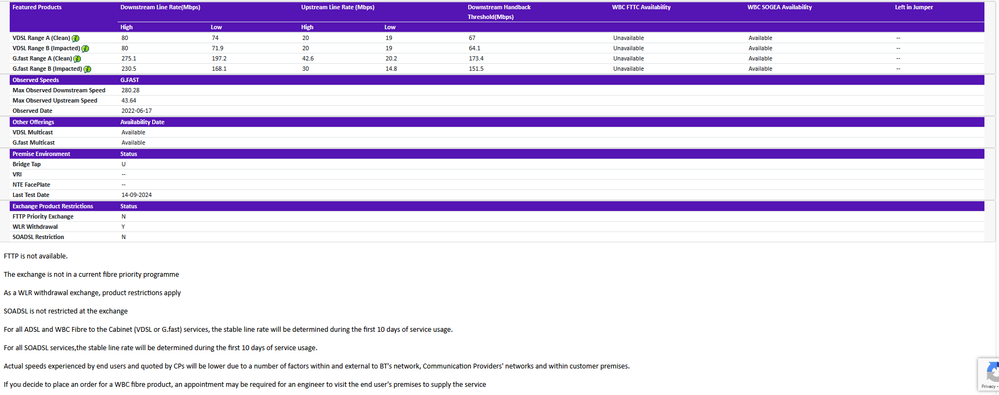

See below mine and my neighbour's results we are both linked to the same exchange

Re: Openreach Refusing to Resolve Fibre Availability – Likely Database Issue
Yes I have BT broadband Gfast and phone
