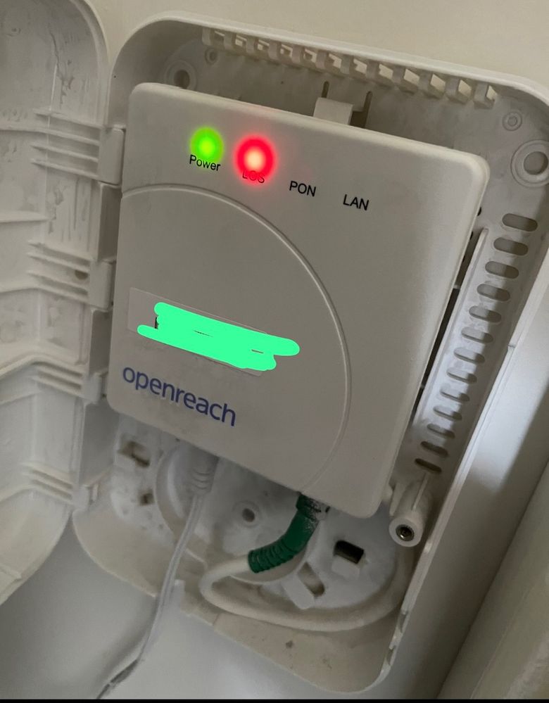

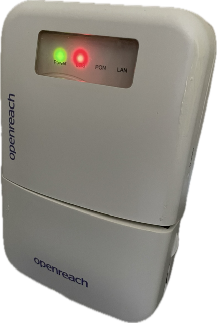

If the openreach fibre device is an ONT like this then get serial number and phone FTTP TEAM 08005874787 and they should be able to help

My device like this.

Although the serial number of the ONT may help in locating the address in the records systems , you won’t be remotely brought into service as the LOS ( loss of signal ) light indicates that there is a physical problem on the fibre itself, so will need an Openreach visit.
Is the property a relatively new build ? , the plastic case around the ONT suggests it is , if it were a DSI ( developer self install )  the developer fits the ONT , that may explain why the LOS light is lit ( if the developer never told Openreach that the plot was called off ready for occupation ) , if it were fitted by Openreach , then presumably sometime between OR completing the install ( leaving the PON light lit and no LOS light ) and now , there has been some interference or damage to the fibre causing the LOS

Yes, this is new build, I think it is set up by openreach, as the case have their logoimage.png

With new builds there are two ways the ONT can be fitted inside each property , by the developer themselves, basically Openreach deliver all the ONTs the developer will require for the site , and the developer uses their own staff ,  usually someone like an electrician ,  to install the ONT within the property, it’s a simple job and OR pay the developer to do this ,  it  could explain why the ONT although fitted and powered up etc.,  isn’t actually working ( signified by the LOS light being lit ) , even when it’s a developer self install ( DSI ) Openreach still visit to connect ( splice ) the fibre to the network.
Its possible the developer never told Openreach that this plot is complete, hence the apparently unfinished job  ( I’m speculating it’s not spliced )  or it was completed, either by Openreach or a combination of DSI and Openreach, but has subsequently gone faulty ….the point is it isn’t going to work by being switched on remotely, there is an optical problem that need addressing, after the actual address issue ( pun intended ) is resolved.
If the developer is still around, you should ask was this plot ever called off correctly with Openreach and is the Openreach FBC ( field based coordinator ) still liaising with the site manager .
Problems can arise if the development is dragged out over an extended period, problems like developers going bust and the site changing hands can cause issues, and developers squeezing in extra plots that were not in the original plans submitted to Openreach can cause issues , anything like that happened in your case ?
