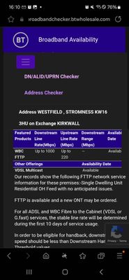

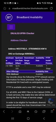

 ok.  Thanks for the pointer.  These are screenshots of the information received
2,055 Views

That indicates FTTP is available with no issues, so no idea why Openreach keep cancelling.

You say your property is 100 yards from the road and there is another property between your property and the road ….the checker information shows single stage installation process and overhead ….100 yards is over span  length ( but obviously this is only a guesstimate on your part ) but if the span were over length you would expect to see Openreach , they couldn’t complete but would be on site , I take it you haven’t seen Openreach ?
The telegraph pole that would  serve your address presumably is on the roadside , is there a direct line of sight from the pole top to your address , is that span no more than 75meters ( if it crosses over a road ) or 85metres if it doesn’t need to cross a road , and is your  address two stories or more high ( so no danger of the wire hanging too low ) and the other property between yours and the road wouldn’t interfere with the ‘flight’ of the wire ?
If the address you have posted the return for is yours ( rather than the property in between yours and the road ) and there is no problem with the span length ,  height and there is a direct line of sight to the pole top from your property it is odd that your orders  are being cancelled , if that’s the case all you can really do is ask the ISP (BT presumably ) to ask Openreach for the reason , that’s if it is Openreach that is cancelling the order and not BT
