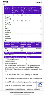

https://www.broadbandchecker.btwholesale.com/#/ADSL/AddressHome
If FTTP is available then it should show here , enter you flat address and post the results, the pertinent part will be similar but probably not identical ( it should differ look  if it’s MDU )
WBC FTTP
Up to 1000Up to 220--AvailableKCI2 Assure
Our records show the following FTTP network service information for these premises:-Single Dwelling Unit Residential UG Feed with no anticipated issues.
TBH , I wouldn’t necessarily take the installers word as gospel, a very small MDU may be served in a similar fashion to a SDU ( single dwelling unit ) but if any third party involved ( like a cable would  have to pass over the ground floor wall to get to the customer on the first floor ) the ‘potential wayleave’ requirement would be noted on the survey and mean a KCI2 ( two stage install ) and obviously the order depends on that wayleave being granted , otherwise the order is not going to proceed , KCI2 shouldn’t be appointed, any initial date is advisory only , while  any mitigation or permissions are arranged.

 Photo  attached - I hope you can see it.
It says:
Our records show the following FTTP network service information for these premises:-Single Dwelling Unit Residential UG premises served by 2.5 Inch plastic duct 56.
FTTP is available and a new ONT may be ordered.
The exchange is not in a current fibre priority programme
As a WLR withdrawal exchange, product restrictions apply
SOADSL is not restricted at the exchange
Featured Products Downstream Line Rate(Mbps) Upstream Line Rate (Mbps) Downstream Range (Mbps) Availability Date FTTP Install ProcessWBC FTTP
Up to 1000
Up to 220--
3,368 Views
Message 10 of 12
Re: Openreach won’t supply landlord with info no ISP
OK , strangely your ‘flat’ is recorded as a SDU rather than a MDU , that’s either an error , or the flats within the MDU can be regarded as individual units , it also UG duct , so it’s something of an oddity as that should mean a duct that is visible on an external wall , or if two addresses, a duct each on the external wall .
If the MDU only has 2 ‘units’ how are they arranged, one ground floor , one 1st floor , or both have ground floor rooms ( so more akin to semi detached houses ) , as you mentioned stairwell presumably it’s an upper flat and ground floor flat .
If one upper and one lower flat then there cannot be a duct to the upper flat , it must either be internal cabling from a ground floor location ( so the duct goes inside to a distribution point inside ) or duct to an external wall block and distribution from there to the ground and first floor property, if it’s an internal distribution for the copper service it’s definitely the wrong SNN ( survey network note ) .
You don’t say if the installation process is single stage or KCI2 assure , but I suspect the survey information is wrong , however there doesn’t seem to be any barrier to ordering service, unless the service you ordered with Sky isn’t actually cancelled.
