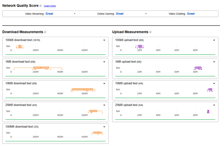

Cloudfare actually allows you to see what is going on with the connection.
The connection is optimised so small chunks of data go relatively slowly and large chunks of data go full speed as you can see from the image below.
