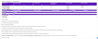

Use the address checker here & post the results.

Results from Address Checker:

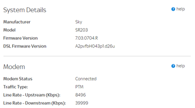

and my stats from my router (sky):

although checker shows you can get faster speeds than you have it looks like you have selected a SKY package with max 40mb connection speed  you could upgrade and get faster
Or you're paying for a higher speed but on the wrong profile...
