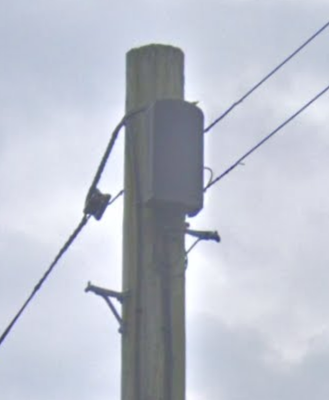

Also just to check something on this. I'm pretty sure the communications come overhead. Would I be right thinking this is a junction box most likely? This is also the box that connects the neighbour so wondering if it's still possible one line from it is still copper and another is fibre? Or is it only possible that fibre has been linked down alone?

The line being disconnected at some point may be a bit of a red herring. I moved into a rural property earlier this year. No phone line present, let alone a BT master socket in the property. Although there was what I think was an old copper line, cut, hanging off nearest pole. Wholesale checker showed FTTP available. I ordered through BT. A couple of weeks later Openreach showed up and hung a fibre cable from the pole and FTTP went live same day.

This it the type of "box" for pole mounted FTTP. Need not be on nearest pole.
