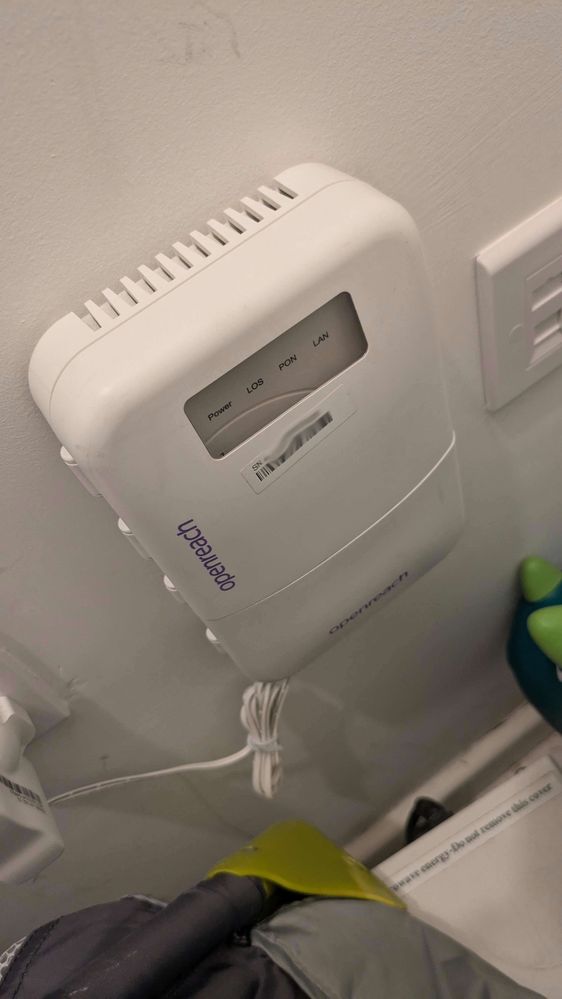

I've attached a picture of the box - is this broadband?
Can anyone identify what it is and why I can't get it connected?

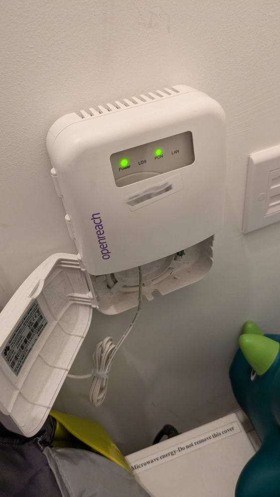

Is the ONT powered up (it doesn’t look like it is ) if you power it up what lights are illuminated.
It’s not very likely but in some new builds (this address is almost certainly a new build as the ONT is inside a plastic case fitted on an electrical patress box ) you can get a situation where the ONT was a DSI (Developer self install) so the ONT gets fitted by the builder not Openreach  , then access to the property is never offered to Openreach to finish the installation and authenticate the ONT by the developer or occupier , this can arise (for example) if the apartment is bought ‘off plan’ to a property investor and never immediately occupied and when Openreach call , no one is home to grant access or the developer goes bust mid point , with a new developer taking over years later (that type of thing ) .
This lack of a completed job can be indicated if the PON light is flashing or the LOS light is lit, Openreach try to gain access a couple of times when the development is ‘live’  but then remove the address from records after a couple of attempts.
As far as going forward, call BT have the ONT serial number ready if you power the ONT and the PON light is steady green , it may help locate the property in ‘records’ , although if it’s a DSI install gone wrong and the PON is flashing or the red LOS light is lit , that may not help )

Sorry for the late reply.  This is in my sons flat so it took a while for me to get the picture.  The Power and PON are a steady green.  No other lights are on.  I'll try calling BT next week, although I don't hold up much hope and expect the "Computer says No" response.
