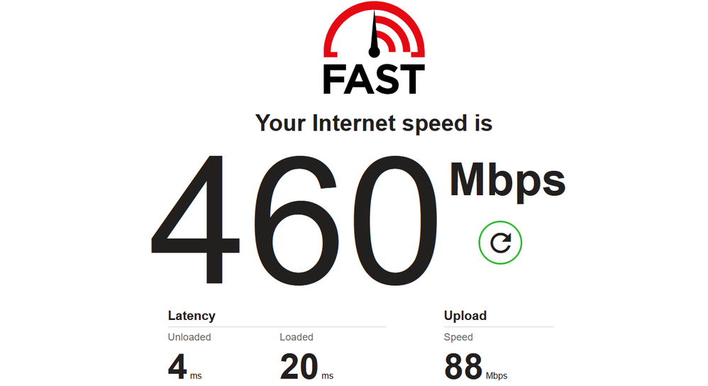

Hi, I sure I'm not the only one with the problem but i upgraded to Full Fibre 900 Halo 3 on Wednesday, i've been keeping an eye on things and my internet speed is sitting around 400 - 500 mb, this is on a wired connection directly to the Smart Hub 2 which has Firmware v0.39.01.04077-BT.  Also on the hub i have switched off wifi and have nothing else connected while testing. Ethernet cables checked and replaced with new cat 8 cables just to be sure and laptop is a fully updated gaming machine. I'm also on the Halo 3 guaranteed min 700mb package. I would appreciate if someone could have a look at this for me. Many thanks in advance.speed1.png

Ok this is weird, just wanting to know if anyone has similar, basically OR engineer came out and respliced fibre due to a fault and DL speed went up to 980mbps,  couple hrs later it was back to 400mbps. Second OR engineer came out and replaced ONT, He connected directly into ONT and was only getting 400mbps roughly DL speed even though the ONT is checked at back end and opened at over 900mbps. He returned the fault to BT as they think my line is throttled or not set up correctly, BT have now escalated the fault back with Open Reach. Don't get me wrong, everyone has been helpful but it seems to be going round in circles. Basically my line is opened at 900 mbps but the throughput is limited to under 500mbps.
Has anyone seen a similar issue and if so, what was the fix ?

Try connecting your laptop directly to the ONT , and set up a PPPoE session, and try a speed test etc, this removes the router as the potential problem .
If you have had confirmation that your service has been correctly configured as 900Mb and not 500Mb , then if the direct connection to ONT is still around 460Mb then it presumably is an issue at the headend ( everything between the OLT headend and ONT is passive ) however although you have a powerful gaming machine capable of Gb speeds there are a myriad of potential software issues that could be responsible for poor performance , so unless you have already tried a different Gb capable device , you may want to explore this ….FYI , optically your connection is identical to every other member on your PON , if you are correctly provisioned at 900Mb and your ONT has already already swapped out , then it cannot really be just your ‘line’ affected, but every other person on your PON .

The Open Reach engineer connected directly to the ont and confirmed only 400mbps on his laptop as well, I have tried both mine and my daughters laptop as well as an xbox series X and all sit around the 400mbps hardwired to router. I have had both laptops connected to high speed  before and have seen them test out 980mbps before.
