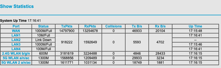

Thanks - it looks like the router *should* be very capable at those speeds. Will try their mobile app.  Thanks for the suggestion.

Does this help?

Looks like the Netgear QOS functionality was the culprit.  Thanks for pointing me in that direction!

Thanks - Access Control was already off, but QoS being on was the issue.
