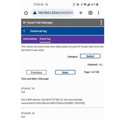

Smart Hub event log stops logging
I have been plagued with a problem with the logging on my smart hub. Once the log reaches more than 150 pages it stops logging. At this point my home network becomes unreliable and some devices are unable to connect to the network. A reboot of the hub resolves the issue temporarily and it starts logging again only for the problem to reoccur. Has anyone else experienced this issue? The only way to clear the log is to factory reset the hub which is a pain. In the screenshot below the time is 10:36, but it stopped logging at 07:03, soon after some devices reported being offline. This is a replacement hub in an effort to resolve the issue. It's a BT Hub 6A with firmware from May SG4B1000E079
