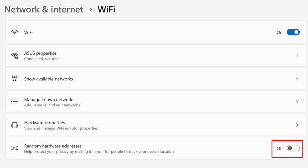

W11 also has MAC randomisation that should also be turned off.

Good point but not necessarily, it would seem.
I've just check my 3 year old Win 11 Pro laptop and that setting is not there.  I suspect it depends on the capabilities/age of the network card.  Mine's only 802.11ac.

@WSH
Odd, my Lenovo is four years old, also with ac. I thought it was baked into Windows rather than hardware dependent.

Very odd?
I've never seen it on Win 11 but I'm mostly a hardwired man anyway, so the whole Wi-Fi thing is usually not there.  I suppose it's implementation is inevitable if other manufacturers are doing it but it's definitely not present on my Acer X515EA.
Just for reference, is that setting on or off by default?

@WSH
I believe it was on by default as I recall switching it off. But if it is indeed hardware dependent, then I guess it could be up to the hardware manufacturer to make that choice?
