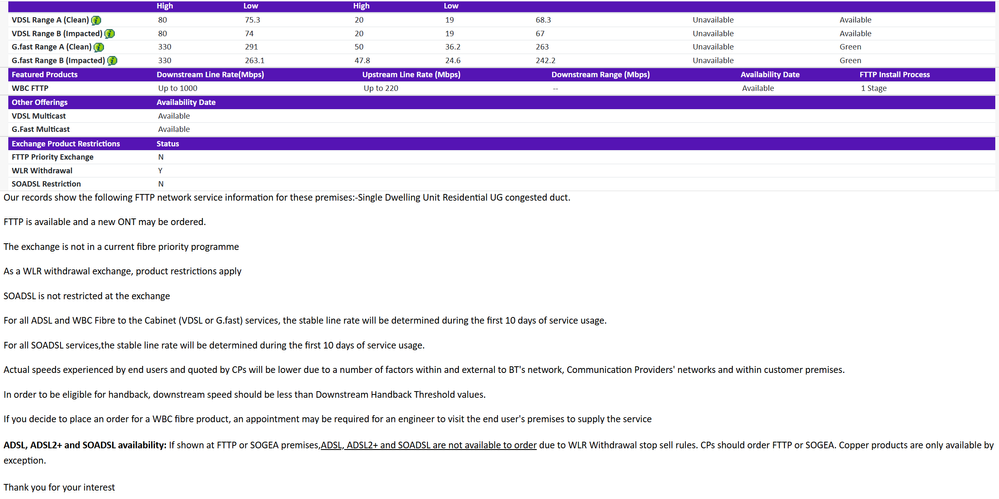

Hi
I'm moving from Virgin Media after 20+ years and currently waiting for engineer next week. There isn't any telegraph poles nearby as far as I'm aware so surely the CBT must be underground somewhere? It says my premise is eligible for FTTP openreach as it wouldn't let me order otherwise and when I check with BT's address checker I get these results.
It says FTTP is available but then also says No for Priority Exchange?
I guess my questions are:
What does FTTP Priority Exchange: N mean?
What does FTTP install process 1 stage usually mean, will I need my front garden/back garden dug up?

Single stage means Openreach expect to get your service in with a single visit , somewhat strangely though that’s not the norm when the survey notice states a potential problem ‘congested duct’.
From the early 1990’s the standard BT ( as it was then ) service method for houses was a fully ducted route  so if your house was built after then , there will be a duct , but there was something that caused the surveyor to indicate a potential problem…if your house was build in the 1960’s up-to  the early 1990’s , its an underground service but not fully ducted method, in those cases excavation is to be expected but the surveyor note is different, it would say ‘partial DIG’ , but it’s possible the surveyor has used congested duct incorrectly, or there has been a change in policy to use that survey marker ( I’m not as upto date as I once was )
No need to get hung up on priority exchange, that’s just where copper products can be ordered at all , as FTTP is available and is the default once it is available, it’s an irrelevance.
Most underground services are from the front , from joint boxes  in the footpath , excavating may be necessary should the existing duct be blocked but they would obviously ask before digging in your land , if the blockage was in the footpath, they obviously dont need your permission but there is no need to worry until it’s established if the duct is OK or not , it’s only a suspicion that its ‘congested’
