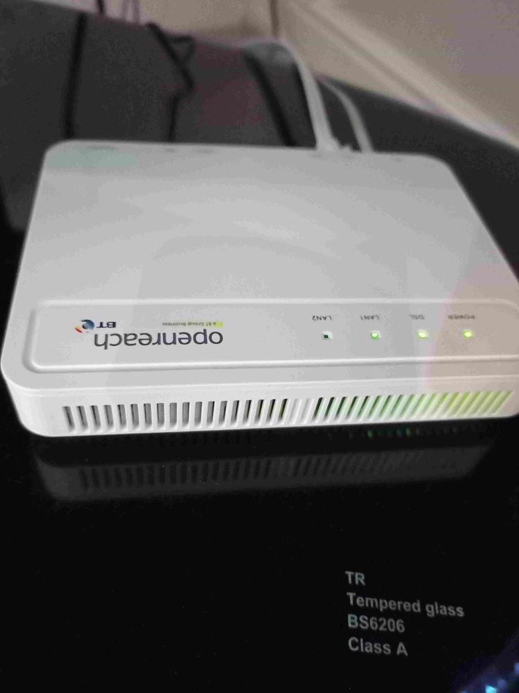

I think I have FTTC (so copper to our house). I get speeds of around 50mbps around our house on WiFi and I get Broadband from BT. I have attached photos of the box on the wall and my modem that connects to my Smart Hub 2 via Ethernet. I am thinking of switching to Sky or Plusnet but am worried about a drop in speed if I do so. I am even more confused as the Plusnet chap on chat said I would be going from BT cable to copper if I switch to them. I thought all these providers were supplied via BT Openreach and as full fibre isnt available in our area yet all speeds would be similar for the Superfast fibre.
Any thoughts please?ModemModemWall boxWall box

Yes, that's an FTTC modem.
Switching to another Openreach provider should yield exactly the same speed. If you put your address & phone number into their web sites, you will get an estimate of speed & a guaranteed minimum.
If you told the Plunet guy that you had a modem he was maybe assuming that you had an ONT full fibre modem.

You have FTTC, fibre to the cabinet and then copper to your house. Your speed will remain the same regardless of provider.
As an aside, you don't actually need the Openreach modem if you have a Smart Hub2, you can just move the grey cable from the DSL port on the modem and plug it into the DSL port on the SH2 and disconnect the Ethernet cable between modem and hub if you wish.
