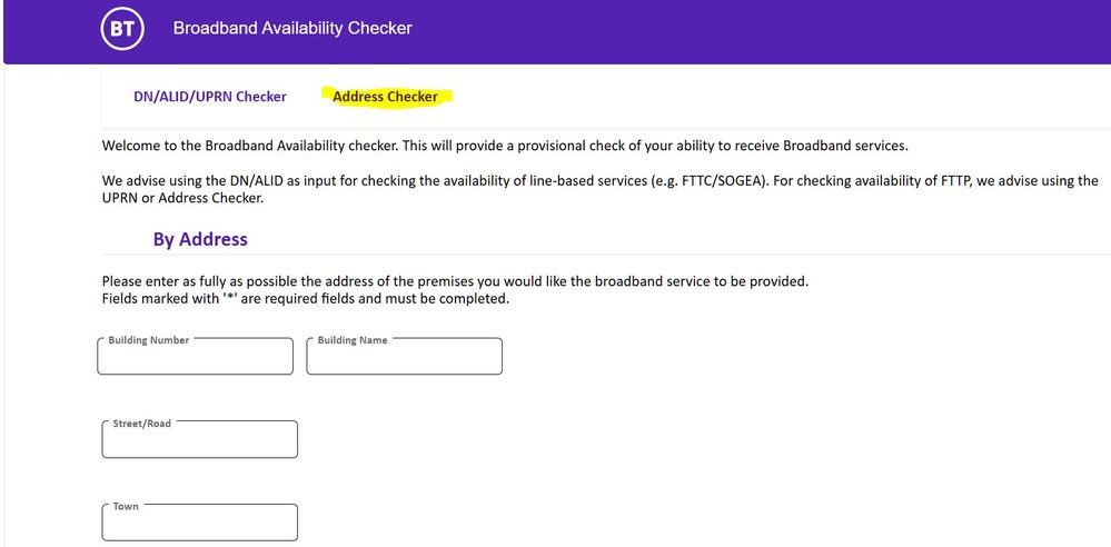

Use the address checker on the page below, and post the results, but edit out your address details first, but leave the exchange name and cabinet number showing.
Please include all notes at the bottom.
This page.

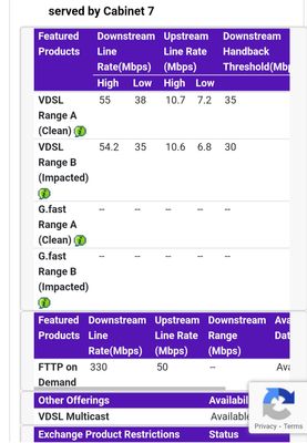

 This is my results.

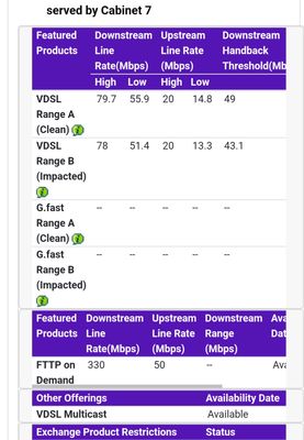

 These are the results of a house a few yards away from me.
Couldn't crop out address without losing the exchange but it's the Valley exchange. And yes BT customer.

The cable from the cabinet to your house, must be longer than your neighbours. Cables do not run in a straight line. Your neighbour also must be much closer to the cabinet.
