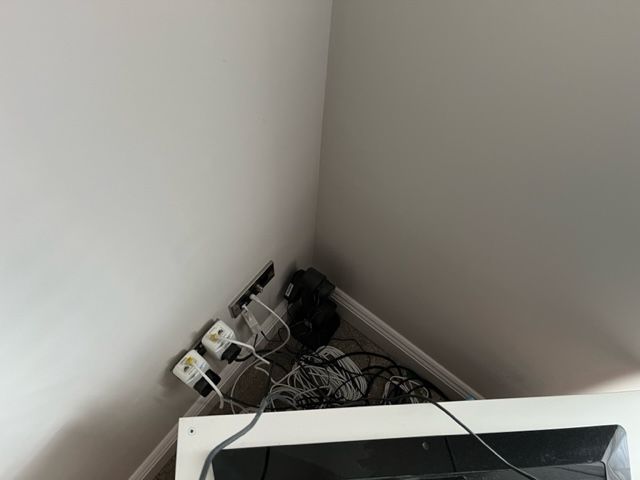

Our  wifi router and BT tv box are all in the corner of the living room as when we moved in we were told this was the only place we could have it set up. (red dot on right side of house)

I'm struggling to understand what you have posted, it doesn't make much sense and the photo of the current setup just seems to show  a couple of powerline adaptors and a mess of wiring.

Please ignore the wiring, the photo was meant to show the sockets on the wall.
