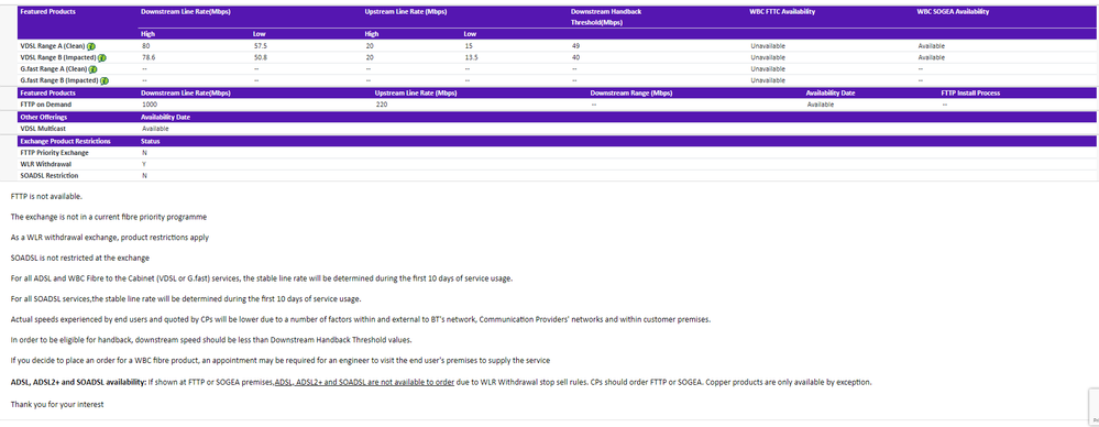

Message 7 of 7
Re: full fttp to my house
