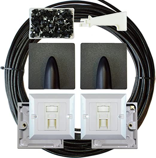

It is best to buy a Cat5e or Cat6 external kit with face plates at the source and terminal. I’m fairly useless with DIY but found it very easy to install a Cat5e extension around the outside of my house (two in fact). You can install all twisted pairs.
You can buy the kits with everything you need (apart from a drill to make the holes through the walls) including cable, faceplates, clips, tools, instructions etc. from a well known auction site or Amazon.
I’m sure that there will be lots of tutorials on YouTube if you need some help.
I should add that you could use your existing patch cable at one end and buy another at the appropriate length at the other end. With some kits the patch leads are included.
