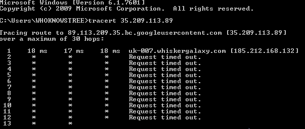

Not a BT problem, the IP you used shows exactly the same for me using my VPN, which you didn't use for your TracePath.
I'm with a different provider so it points to a problem elsewhere.
