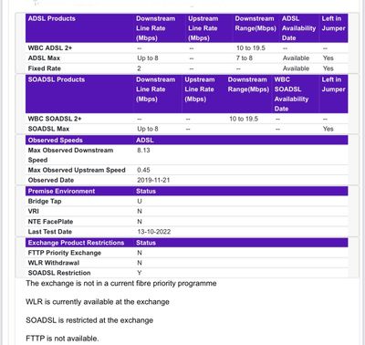

Hi @Keith_Beddoe and @imjolly thanks for responding.
I’m having to do this on my phone, I have no idea how to show the results in this reply as the screen shot exceeds file size.
I feel out my depth which is perhaps why I don’t have broadband.
Without broadcasting my location, I can say it is a tiny community and there were 2 households awaiting connection mid October (the other household has given up and gone for a 4G option)  the exchange is past it according to OR but it is possible to have broadband.

What did BT say your broadband package was, when they send you a confirmation email?
If it said Fibre 1 or Fibre2, then look at the top line of your results where the line starts VDSL, and see if it says "Waiting List" on the right hand side.

Bingo!! @Keith_Beddoe @imjolly  hope this is viewable

Go to solution
fibre not available in area - copper adsl only.

@RhOda
Its shows ADSL is available, so that is what you must have been offered.
Usually once the phone task has been closed, a follow on task is generated for the ADSL broadband equipment to be inserted, after disconnecting any Plusnet equipment.
This requires another visit to the exchange by an Openreach Frames Technician, and owing to the number of recent strike days, there is most likely a backlog of frame jobs waiting to be executed.
It looks like the line was tested on the 13th October 2022.
Its possible there is a fault on the ADSL equipment in the exchange.
