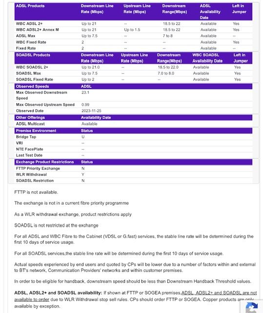

Background first. We have a BT landline and Broadband, all connected via copper direct to an exchange (Bromley SE London), which is about 200 feet from the front door. Although a cabinet is fairly close by, Openreach engineer confirms that we are straight to exchange (and have been since house built in 1969). Not yet contacted about Digital Voice (DV) but expecting to very soon (contract up for renewal end March). Broadband performance pretty good (not heavy users).
Whilst I’m comfortable with DV, I’m more unsure over where things stand in the near future given the upgrading and retirement of copper (as I understand things). Eg are we faced with having to connect (in some form) to the nearby cabinet or will copper remain until fibre is installed? The cabinet is in an adjacent street - our square of terraced town houses does not have Openreach fibre to properties and is not currently a priority for upgrade. I attach the BT checker for our number.  Is this a question I should direct to BT itself?

Welcome to this user forum for BT Retail phone and broadband customers.
Its quite likely you will stay on ADSL forever, as its not restricted and FTTP is not available.
If your happy with the speed then without trying to find another non-Openreach provider, that is the speed you will get.
As for Digital Voice, yes you will get that eventually, as it works just as well, and perhaps even better than FTTC, as the broadband powered from the exchange and you are not relying on batteries in a cabinet.
DV on ADSL is a fairly low priority, and a lot depends on when your local exchange is being fully closed down, so I would not be concerned at the moment. But if you re-contract then you will be moved over to it.

ADSL users are last on the list along with line only customers (No broadband), when it comes to upgrading it won't cause issues though, it's the PSTN that is being switched off, not the actual copper cables from the exchange to your home.
Openreach are releasing a solution for ADSL customers called SOTAP (Single Order Transitional Access Product ) on December 1st 2023 (next week), once that becomes widely used then BT/EE will know when to offer it and when to look at alternative options.
Digital Voice only needs a tiny amount of bandwidth, 512kbps is enough but Openreach are making a 1/1 (1mbps down and 1 mbps up) SLT to support customers who don't use the internet, there are also other ideas being trialled to make sure nobody goes without a telephony service, you'll be fine 🙂

There is no FTTC or FTTP available for the OP, he has to remain on ADSL, currently no regrades on ADSL include DV
