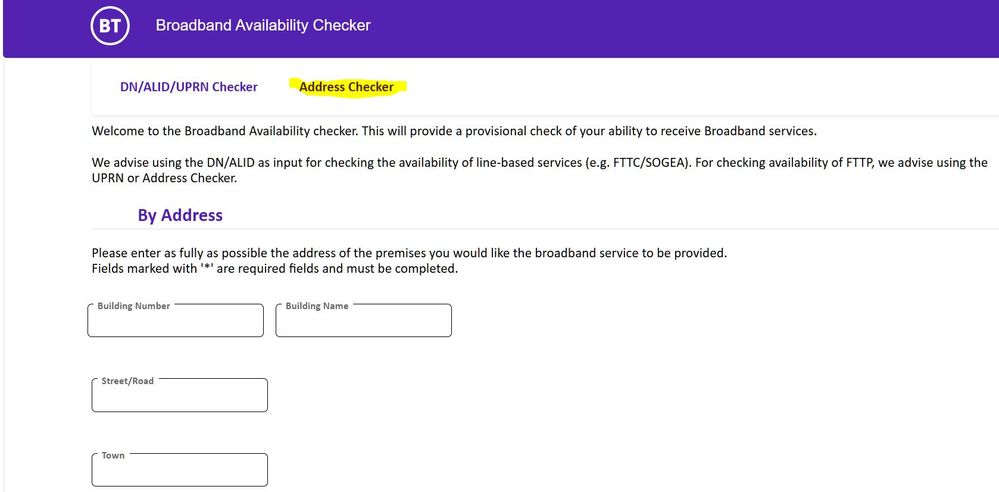

Use the address checker on the page below, and post the results, but edit out your address details first.
Please include all notes at the bottom.
This is the page you need to see.

The obvious ‘tell’ if the house has FTTP installed is the existence of an ONT , although occasionally muppets will take the ONT with them when they move out  , but a CSP should exist ( Customer service point )  usually a grey Openreach box on an external wall , if FTTP is available but the address hasn’t yet taken a FTTP service, the method will be whatever the current copper pair service takes , so if telegraph poles and overhead cable , that’s how FTTP will be provided, if underground duct , that’s how FTTP will be provided , the only method worthy of note is if underground but with DIG ( direct in ground ) copper cables , then duct will need to be provided ( so an excavation needed ) ….the checker URL posted will show this information.
