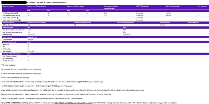

If I use the checker by using my landline telephone number I get the following screen:

That confirms that the Openreach records are correct, and you have a connection speed of 27.23Mbs download and 2.93Mbs upload.
There is no reason why another provider, who uses the Openreach network, cannot provide the same speed.
If you are out of contract with BT, then its a good time to negotiate a good deal.
