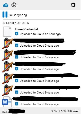

I am using BT Cloud 21.12.15 and have a problem with the Cloud Backup process being unreliable.
I have various folders on my computer set for "continuous" backup to the cloud (i.e. NOT "weekly" etc - I have checked this). I have recently been doing a lot of work creating new files and updating documents that it is very important are backed up to the cloud, but none of these have been uploaded even though the folder in question is definitely selected for continuous backup. I have not changed any settings at all recently; the backup used to work at least to some extent - I'm not convinced all my new files were being backed up, but as can be seen from the screenshot, it did backup some from the folder in question 5 days ago and also 9 days ago. There are also new documents in other folders that are also set for continuous backup that have NOT been backed up - I saved the screenshot used above into a folder that should be continuously backed up for instance and BT Cloud Backup has not  sprung into life, so it is not a problem with just one folder. The ONLY thing that DOES seem to be backed up - and this same item gets refreshed every time I restart BT Cloud to try and make it work - is ThumbCache.dat which is not something I actually particularly care about(!) As you can see I have 700GB free, so space should not be an issue.
 As a "workaround",  I am currently "uploading" (as opposed to automatic backup) the most critical folder in question just so that I have a backup of the most important items, but this is not in the correct place in my folder tree of previously backed up items, and doing this does not solve the underlying problem of why automatic backup has become so unreliable as to be practically useless - especially given that it used to work... I need to be able to be confident that ANY new item that is created within ANY folder that is set for continuous backup will in fact be backed up, ideally within the hour!
Many thanks for any help or insights regarding this problem.

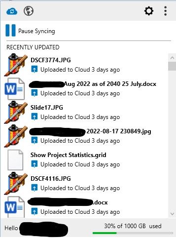

Just a screenshot to show how long ago it was that anything was backed up, despite BT Cloud Backup being on continuously since my last post 3 days ago:
Screenshot 2022-09-07 102051.jpgYou can tell by the file names when some of the documents and images were created that first got backed up 3 days ago - there are other files from a similar timeframe that have still not been backed up at all. The desktop client has the icon for "Syncing" - it *knows* it is not up to date, or the icon would change - so why is nothing happening?!
I am guessing that @SeanD is probably on a very well deserved vacation, so I will await his return to see if he can help me, @bluefin , and the other BT Cloud users with similar issues, to regain access to a functional backup system. I don't want to have to manually upload all my files to the cloud, where they are then not located correctly in my computer's folder tree for easy access, but in a separate cloud folder; all I want is for the automatic backup I am paying for to work(!) Many thanks in anticipation to @SeanD .
