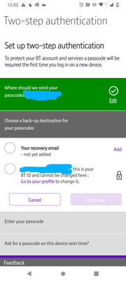

However, having tried to activate 2fa, I now seem so have reached a dead end where all the options are greyed out. (Tried it on two different devices with the same result).
Any ideas how to progress beyond this screen?

As regards setting up 2FA. It may be because you are using MyBT on a mobile device. I used a laptop and web browser to set it up. I found setting it up no problem and on checking just now I can edit it with out issue and all works in the way I would expect it to.
Try using a web browser in "desktop" mode to see if it lets you set it up.
