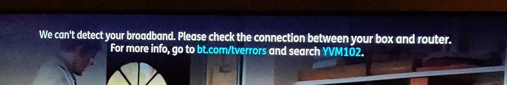

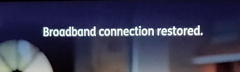

Now the interruptions are different. Every few moments a message flashes up at the top of the screen "We can't detect your broadband". This is then followed a few seconds later by "Broadband connection restored". All the time the programme keeps playing without halting.
I am baffled. Especially as to why a wired connection the to Smart Hub 2 with several hundred Mbps bandwidth isn't enough to stop the messages, even though the programme plays through them without interruption.
The message on wired connection:
Then seconds later:

Following your suggestion that there might be a poor connection, I re-tested the two CAT 5e cables at the TV end and got over 500 Mbps from each one, so the connection seems OK that far. I sprayed the ethernet socket on the back of the BT TV Box with a switch contact cleaner and worked the plug in and out a few times to clean the contacts. The box still wouldn't accept the blue cable, but it did accept the red cable again. Testing live TV and some BT iPlayer shows didn't give any glitches, so fingers crossed that might have sorted it. I'll see what happens this evening.
