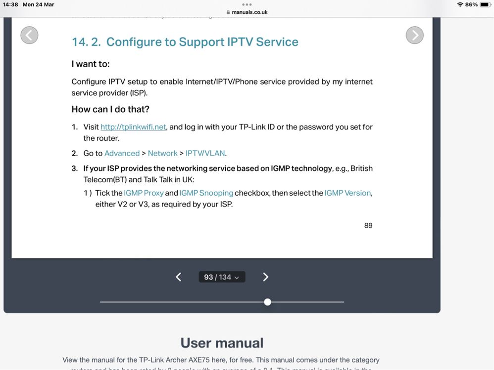

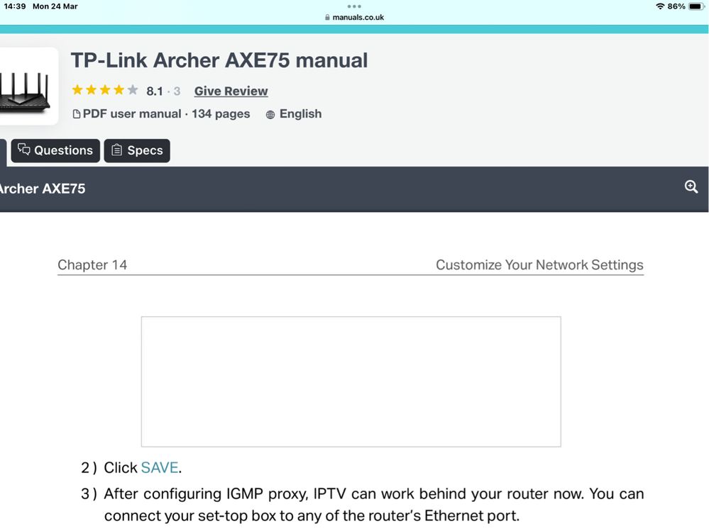

@BelgarionV  From the AXE75 Manual
From what I can see you should tick v3 as this is backwards compatible with v2
