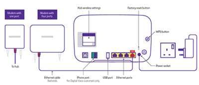

The Hub is definitely in Fibre mode so when you get a moment, could you check and confirm back that the Ethernet cable (usually the one with red ends) is plugged into the WAN port (Red / labelled port 4) on your Hub and the other end into the Openreach modem's PORT1/LAN1 port  like this picture (sorry if its a bit small)

Hi David, I am very grateful for your help, at 82 I feel a little lost with the problem
I have checked the cable is in the correct sockets, which it is, we have the small wall box, and it is in the middle.
The errors are solid with regards to the Freeview channels. It even says poor signal quality alongside the error at the top of the screen.  Kind regards, Brian

Go to solution
Hi David, the power and pon lights are solid on, the lan flickers intermittently. The engineer installed up to and including the Smart hub 2, so up to now, the cable from the wall to the hub, (red ends as you suggest), has not been touched. It does go into the WAN socket, I could try reconnecting it, though they have been gently pushed in.
