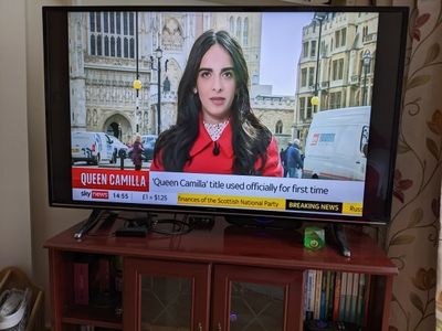

Hi Gareth, here is a picture taken a few minutes ago
Sky News, you can see the black bands at the side
the quality of the image is fine.
I removed the HDMI Cable as suggested, but it is still
the same.
I also re-instated the TV aerial with booster, before
taking the picture.
Mike.

Yep, definitely not right Mike!
I take it the booster is aerial lead in one end and co-ax (aerial) lead out the other to the BT box? Are there any other outlets/switches/buttons on it?  Can’t see how that would affect, but just to eliminate it from the equation, what happens if you plug the aerial lead direct into the BT box other than maybe being insufficient signal to see anything (and assuming you can reach the BT box with the aerial lead of course)
When you said before you had checked the aspect setting on the TV, was that with an aspect button on the remote? Did you go into the settings of the TV and see if there is a display option in there that might be overriding the one on the remote

I had the aerial plugged directly into the box, then from there to the TV,
this afternoon, I have put the booster back on the coaxial cable, no joy,
it is just a little with in and out for the cable, plus an on-off switch, as to
checking the aspect ratio on the TV, I went into the settings and it is fine,
there is no aspect control on the You View Pro box, I think that there was
in the older ones, I have had BT TV, since the 1990s, so I have seen some
changes.
