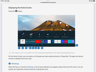

Are you sure you’ve got the SOURCE button set correctly, and not on the ‘external device’ setting?
sorry for the poor image quality, had to reduce the image (from a screenshot of the online manual) to fit the ridiculous maximum image size allowed to attach (it’s the second one from the left highlighted in white)
