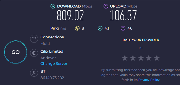

I am not infront of my TV at the moment, but there are no issues with my speed.

@DavGom83
Shoot, that’s twice as fast as mine 😛
I guess that’s not the reason for the IPC6023s then….
