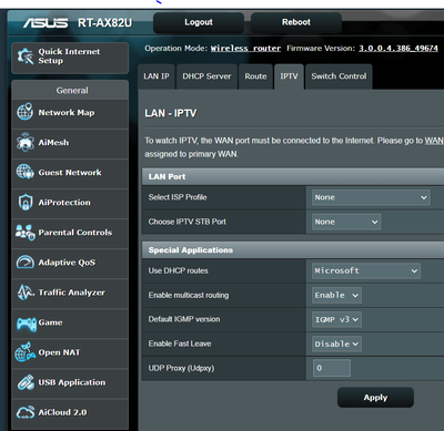

I now have the settings in this image set on the router thanks to previous poster
My BT TV Box pro is now oddly picking up some extra channels: AMC (which i have as part off Entertainment and is 'working') and also BT Sport 1-8 (these are not included in my bundle and give a message about not being subscribed when i try to watch as expected :
but none off my 'normal TV' channels from the package are appearing (entertainment bundle and such)
One step forward, two back 😞 , still perhaps further modem/router settings need changed?

After following the suggestions from @JonMace to check my settings and settings them as per the image in my following post - AMC and BT Sport showed up (even though not subscribred to BT sport so couldn't watch it anyway) but the other channels were missing.
Two days later with no further modifications to the setup and can now confirm all my missing channels + Entertainment bundle channels have now appeared and are working!
