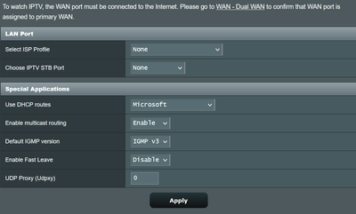

The issue is definitley created because I use an ASUS Zenwifi AX router, rather than the BT smarthub 2 (because I have  a reasonably complicated internal network). If I use the smarthub, it works no problem. So it's a settings issue with the Zenwifi.
All other channels work fine. BT have confirmed I have subscribed to SKy HD.
Does anyone know what settings I need to use? These are the settings that were required to get the TV working initially. But obviously not for Sky HD which seem to require different settings...
Thank you!

I suspect you need to ask ASUS how to configure your router, unless somebody here happens to have got it working, but here is something a bit alarming:-
https://www.asus.com/uk/support/FAQ/1011708/
Note: The router does not supports the enable multicast routing(IGMP Proxy).
Whereas
the BT router does, of course, and multicast is how these channels are delivered.

I'm pretty sure the Asus Zenwifi does do multicast routing, as I currently have it enabled with IGMPv3. That's what i needed to enable to get any TV channels working. But the Asus doc is really not very clear.
If multicast is only used for SkyHD, perhaps that's the problem. But if multicast is used for any other HD channels, or if multicast is used for Sky SD, it's unlikely to be a muticast issue as they all work.
But I'm well out of my depth here as I've no idea what multicast or IGMP are...
