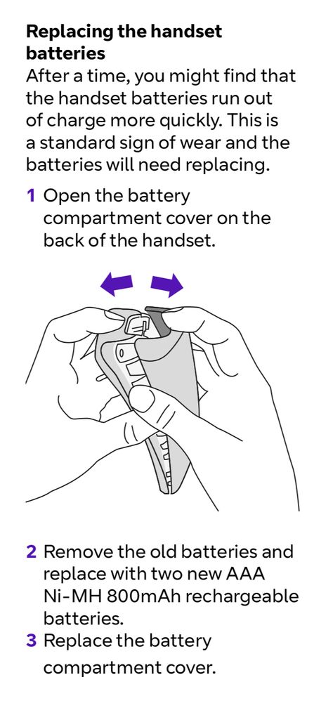

I don’t know if it helps but here is an extract from the BT Advanced Digital Home Phone with Alexa built in User Guide (page 41).

Hi @Nightman67
I just tried following the above instructions and mine came apart really easy !! That is with my frail old hands.
4,409 Views
Message 8 of 8
Re: Advance Digital Voice Phone (with Alexa) can't get past WPS registration
Go to solution
Thanks so much. It looked really tightly held together but did indeed come apart nicely. That has also solved the problem. The phone is no longer asking for a PIN and has now synched to the base/hub. Thanks so much! 🙂
