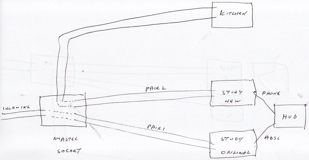

@chrisjp  Its a bit messy but it can be done.
At the study  you need to provide a second extension socket. Leave pair 1 connected to the original socket for your broadband and then wire pair 2 (which should be spare currently) to terminals 2&5 of the second socket. The second socket is then connected to the hub with the double ended BT431 cord.
At the master socket, disconnect the wires going to the kitchen and connect them to the second pair coming from the study. You can just crimp them together within the master socket.
Hope that makes sense.

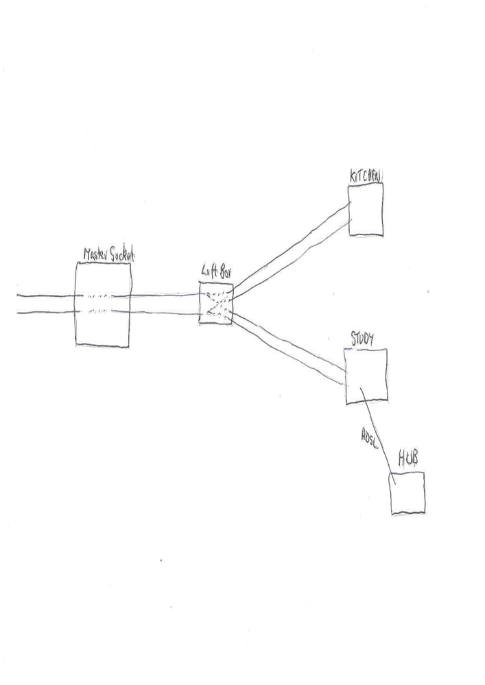

It does, and thank you. However, I think there may be a problem – there is only one cable going from my master socket to the two extensions. This is split in the loft with separate cables going to the Kitchen and Study sockets. And my broadband signal has to travel from the master socket to the Study via the Study cable.

If you have access to the split in the loft, you can simply make the join of pair2 from the study to pair 1 to the kitchen there instead of at the master socket.

Just to clarify – here is the diagram of the telephone wiring

Go to solution
Yep, just do in the loft box what my picture shows in the master socket.
