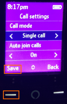

Hi @Andy1234   You need to connect a DV HD Phone and turn off Multi-call. DV allows two incoming lines by default.
Menu -> Phone Settings -> Line settings -> Call settings -> Call mode -> Single call.

That change has worked for others so not sure why not working for you.  Did you remember to save after making changes?
You may need first to try going to hub manager then select phone number and then reset base station.  That will reset the dect part of hub and then you will need to pair phones again and try changing multi to single again

Hi @Andy1234
We suspect that you didn't Save the change to Single call. Would you please double check that it now says Single call.
