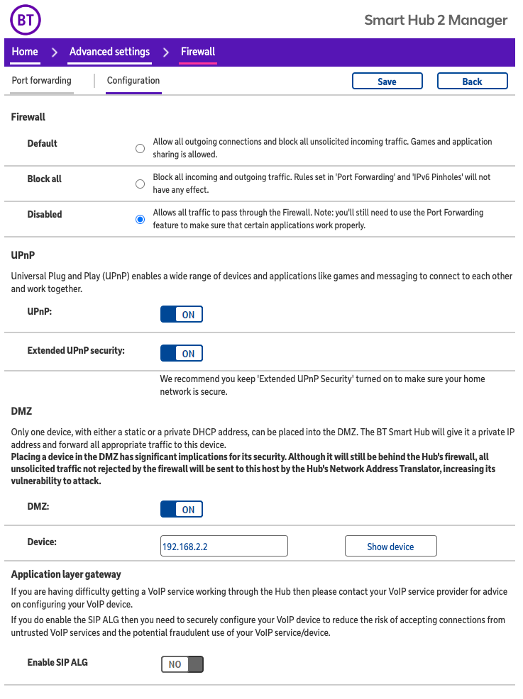

This article explains double nat and how to get around the issues. This is essentially what I have carried out, so my ASUS WAN IP is a private address 192.168.2.2 and my LAN is 192.168.1.1 and is in the DMZ of the SH2 which I have given the gateway address of 192.168.2.1 and subnet of 255.255.252.0. All traffic is forwarded to the ASUS from the SH2...

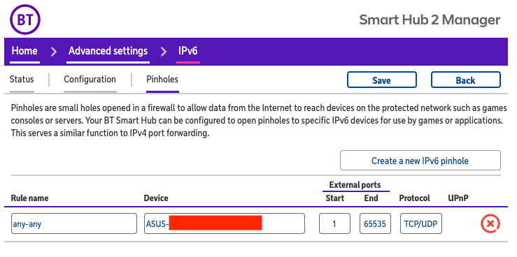

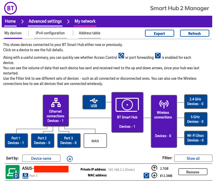

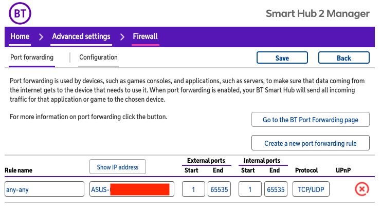

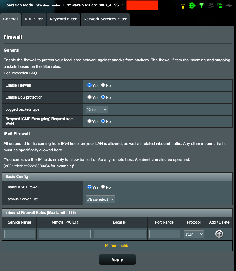

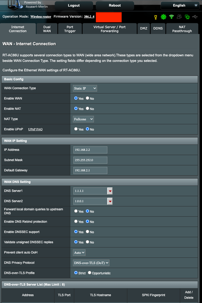

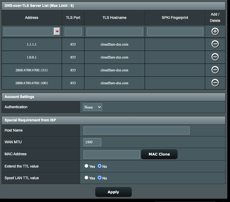

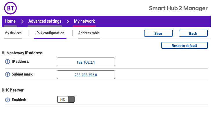

O.k, so here are my screenshots. You should view these and read mine and @choppyc posts in this thread - his guidance helped me get started. I have tried to name the screenshots to give you an idea on where to find the settings, but I'm not sure if their filenames will be visible. I've blanked out mac addresses and personal stuff (red). Hopefully this should help others too but bear in mind that if you do flash your ASUS firmware to Merlin, which I highly recommend, you may need to start your network config from scratch again.
I also use Cloudflare for DNS which isn't necessary but just my personal choice.
Good luck.

- If you're using the range 192.168.1.x for your router and your devices (as I do), change the IP address of the SH2 to 192.168.0.254 (advanced settings) or any other address in a non used IP range. You don't want the SH2 and the router to be on the same IP range.
- If you're using a range that is not 192.168.1.x your your router and devices, you can keep the SH2 default IP address of 192.168.1.254.
- Disable everything (DCHP, Firewall, UpNP, Smart setup, Wireless, IPV6) as advised earlier in the thread.

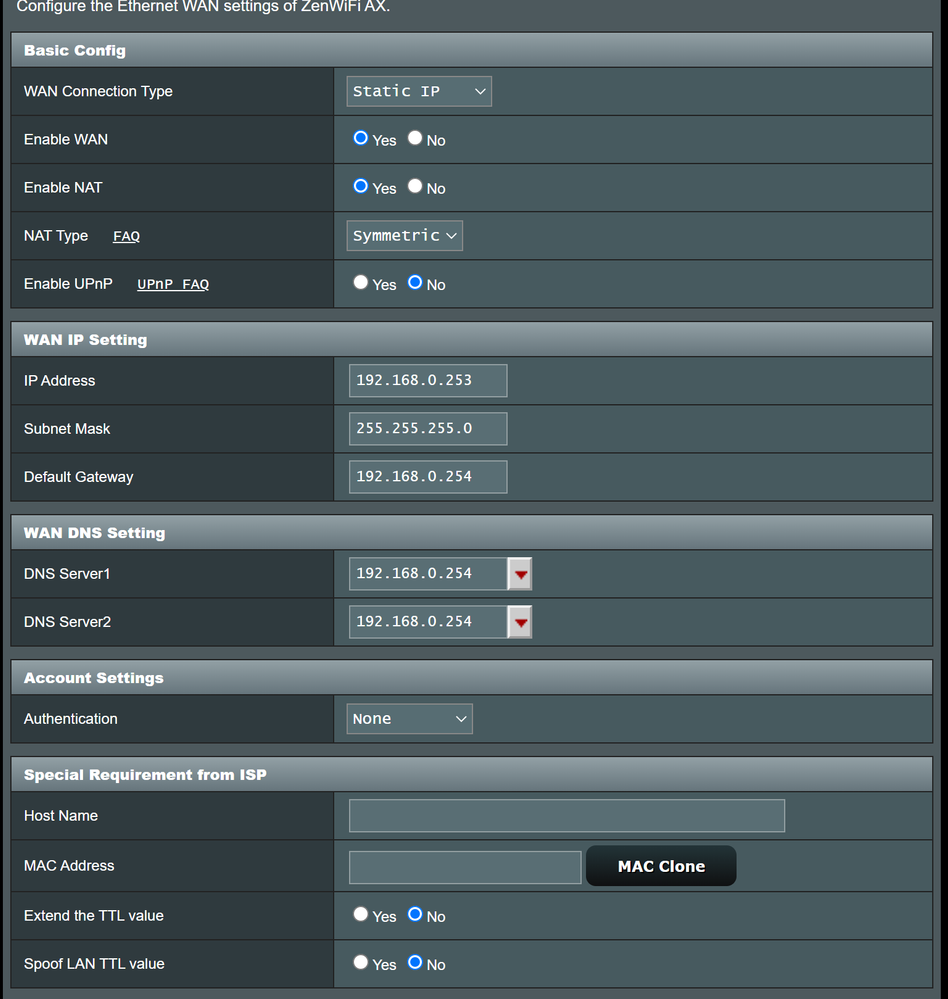

- In the WAN settings, select a fixed IP and specify an IP address in the same range as the SH2 (i.e. not in the range of your router and devices). I chose 192.168.0.253. For the gateway and for the two DNS, specify the IP address of the SH2. In my case, 192.168.0.254.

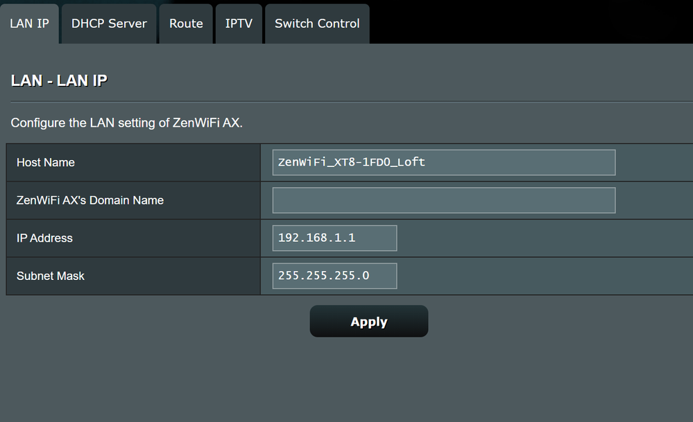

- In the LAN settings, specify the LAN address for your router, in the same range as all your devices. I specified 192.168.1.1 as that's always been were my main router is. The two Asus nodes are at 192.168.1.2 and 192.168.1.3. All my devices are above that, but I reserve the address of all my permanent devices to make sure they keep the same IP address. DCHP is only really used with new devices or guest devices.
