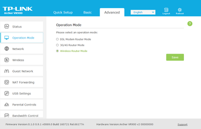

Has anyone successfully gotten this working with a TP-Link? I have the Archer VR900 and it has 3 modes, if I set the router to DSL modem router, the DV connects and the phone works but I've never managed to get the Broadband working this way, only through Wireless Router Only mode with PPPoe and username [email protected], this doesnt connect through DSL mode.
So obviously I'm trying to get both working and simply having the homehub piggybacking the TP-Link just for the DV. Setting a static IP in either DSL or Router Only mode doesnt give me a connection regardless of the homehub bring connected, so none of the solutions here regarding static IPs have worked.

The home hub has to be the first device and the TP Link connected to it. DV will not work if you connect the TP Link to line rather than the BT hub.
The TP link needs to be configured in wireless router mode.
Connect the TP Link WAN port to one of the hub LAN ports. Give the TP Link WAN port an IP address outside of the DHCP range of the hub and set its LAN subnet to 192.168.2.xxx

Oh I see I figured it would be the other way around for a more direct connection but this is working now. Am I fine just using 8.8.8.8 and 8.8.4.4 for DNS on the TP-Link (its required).
6,581 Views
