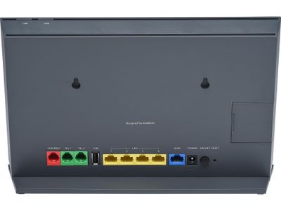

@chrisjpwrote:
 its only BT that has arranged for a pseudo-analogue phone socket to be on their SmartHub 2. You can plug your original phone into this, or you can plug your extension wiring into this, or you can get DV adapters, plug them into any mains electricity outlet you like and plug phones into these. So you can have phones wherever you want them in your house.
Vodafone VOIP phones do not provide any of this functionality and never have done.
Note the two green sockets on the current Vodafone router.
