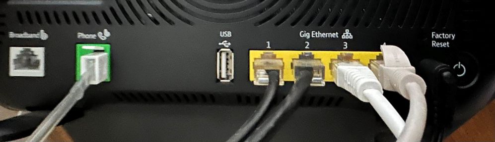

Yes the lifeline unit would need to be plugged into the phone port (ATA port) on back of smart hub 2 in order for the lifeline to be able to dial out and connect over the digital landline service.

You could try a DIY solution and wire the internal extension phone sockets to the ATA port on the back of the smart hub 2 or use an extension phone cable.

@jac_95 which port would it need to be plugged into please? I suspect you're going to say the one her phones are in 😞

I’ve unplugged the old phones for now & plugged in the lifeline. As I suspected it doesn’t pick up the signal from the lanyard on mum’s living room but is at least now working-confirmed with a test call from the base unit.
