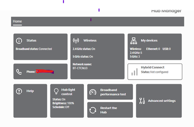

I am at the start point that there is most likely a user error with that user being me but I am not sure where to put that right.
Hybrid connect status is "not configured".  Where am I looking?

If the phone symbol that you have edited out is your phone number, it confirms Digital Voice is enabled.
The problem would therefore appear to be one of registering the handset to the base station.
Do not try to register the handsets to the hub.
