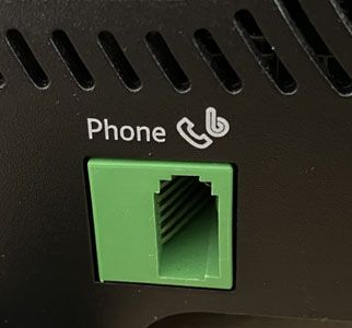

This is about a standalone bell and you are correct in your connectivity assumption.  I have installed loads of these back in the day!
(off topic) the weirdest phone I ever installed weighed about 10Kgs, made of steel, spark/fire-proof for an oil terminal.
I was hoping maybe someone has used the Phone jack on the rear of the Hub to extend an electronic buzzer or ?
See pic.
Thx
ScouserHub Phone JackHub Phone Jack

The bell is currently not connected to anything as BT disconnected it from the landline when switching to DV.
WSH the CEA-40 = telephone call alert & ringer amplifier with flashing light looks really interesting, wonder if it will go into the analogue phone port on the back of the router. The unit is line powered so that is a big bonus!

I came across this video on youtube, it explains everything in detail, basically you can connect the old internal wiring to the RJ11 on the back of router ( but you MUST remove the old income wiring from the street first) at the main jack. He even tries an old  fashioned bell on the old wiring and it works fine. There is a limit to the number of bells/ringers on the router output so beware.

It's actually a BT 431 socket not RJ11 at the rear of the hub.
Be aware you obviously can't disconnect the incoming wires if on FTTC rather than full fibre.
