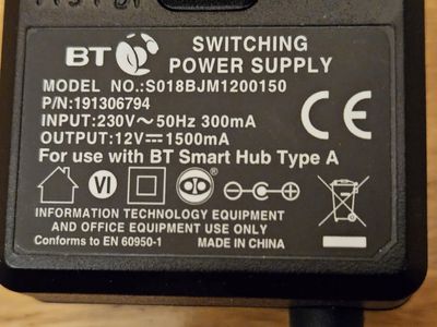

As above - the plug on the SH2 power connector is 3.0 x 5.5 mm and 11 mm long.
Also known as: Philmore # 206, 3.0mm I.D. x 5.5mm O.D. Coaxial Power Plug but the trick will be to find one.
An 'obvious' solution is to search out a 'broken' Smart Hub power supply and cut-off the lead and plug ... ?
Edit:
And the cable specification is on the power supply:
Philip
