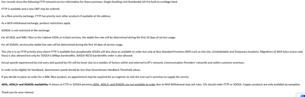

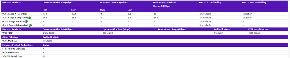

Thanks very much for your suggestion. Here are the results....
