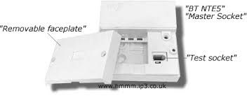

Q2) there is only 1 port on the master socket. (See picture attached). So how does one connect a router and a second/third item (whether it is phone or extension cable). Do I use the test socket for the phone? If I do, where do I connect the extension cable?

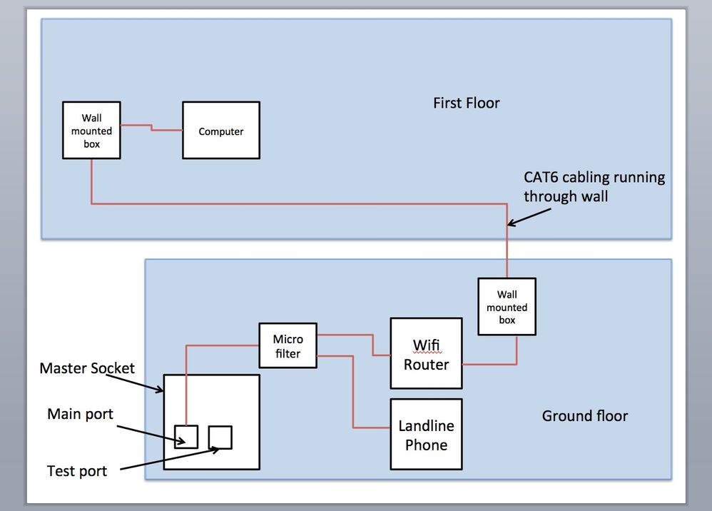

I have attached a picture of what I am trying to achieve.
Question is I have 3 connections to be made, but only 2 ports on the master socket. What is the best way to resolve this please.

The LAN from 1st floor goes directly into the router, preferably by the wiring I previously suggested.
The phone doesn't go into the test socket. You use a microfilter plugged into the faceplate which has ports for both phone & Internet.
If you require phone extensions, they are connected directly to the faceplate of the master socket.

@Anonymous thanks again for the quick response. I can understand that now. I've updated the image as per your responses. Could you please confirm that I've got it right.
I am not sure what a phone extension is. I don't think I need one.
